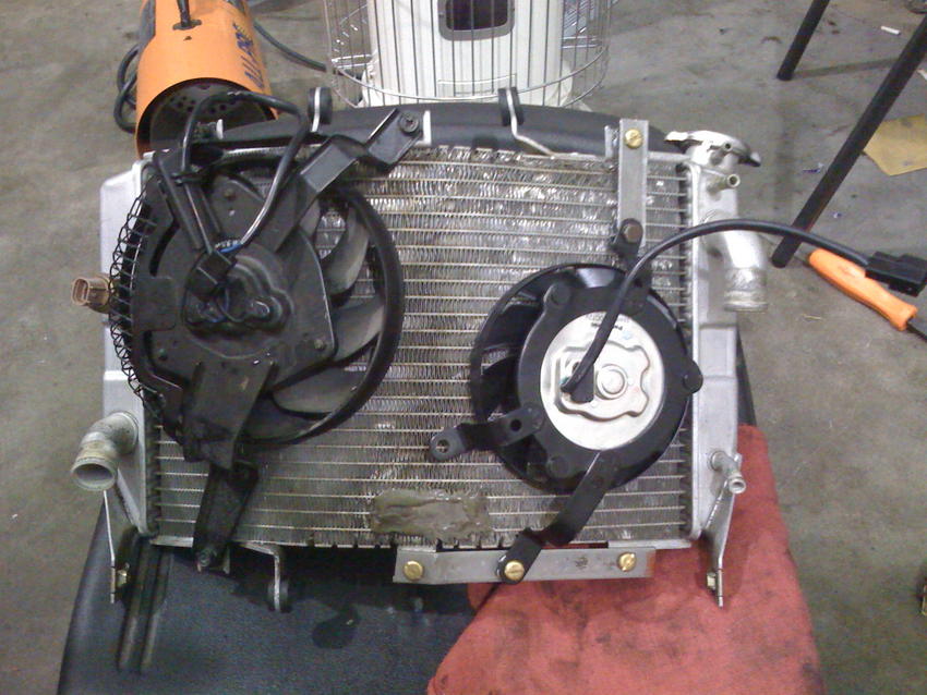

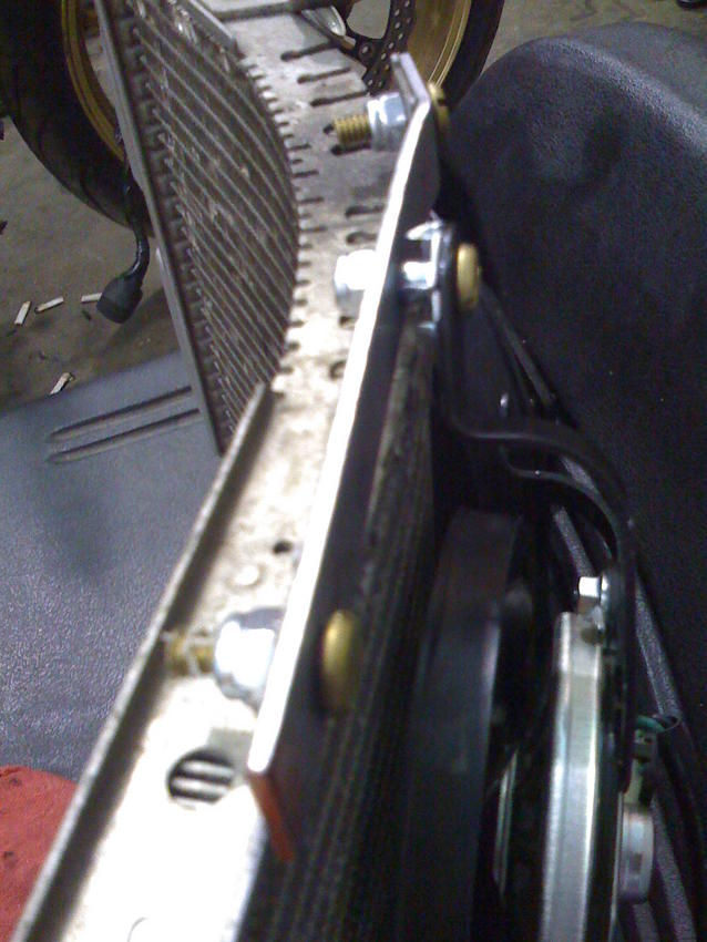

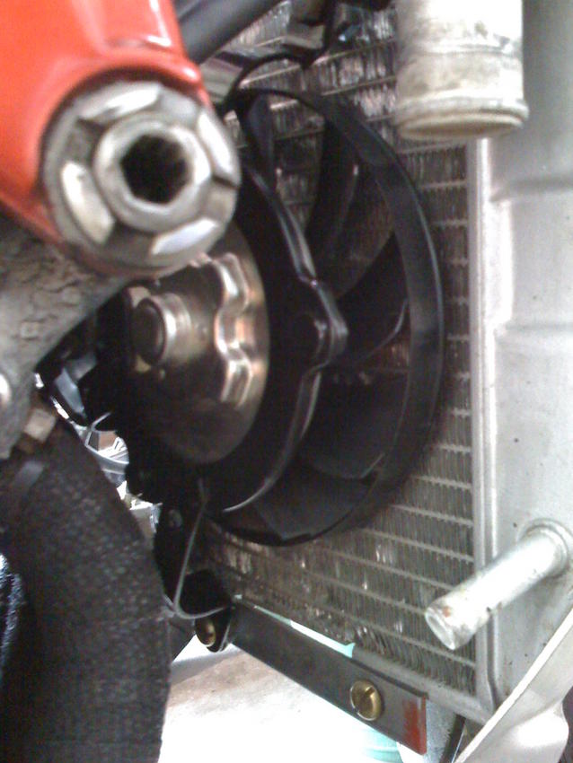

Thought id post up what i just did..
I bought an 07 R6 fan as they are the smallest i have found and push the most air ..
So i had to turn the senser 180 to fit the fan in..
Then i had to figure out the best positioning for the fan..Built my brackets for it and bolted it up. once that was done i mounted it up ran my wires and switch and done.. So ill run the R6 Fan at all times while riding and leave the stock fan to turn on if i need it while riding..

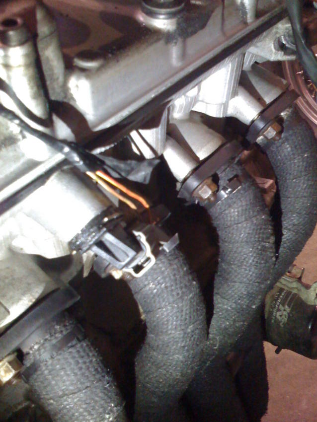

So i have just rebuilt my waterpump. $65 and rapped my headders to my mid pipe $62 and did the fan mod $50. So im hoping my bike runs alot cooler and better for the 09 season. Oh and my head cover gasket was leaking so i had to replace that as well. $20
Sorry about the picturs i had to take them with my iphone..
Once i get my new radiator ill have the brackets welded to it to mount the fan..
