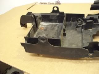

Did anyone find out what size the bolts were for that holds the batterytray in on the front of the tray??
These 2 front tabs on each side where the battery fits??????
please dont guess. Have to know exactly what holds it. Thanks

heres the part number for the bolt..............
BLT,BTTN HD
92017-06016-00 (replaces 90111-06007-00)
i called yamaha up and they said its a 6mm bolt X (he thinks its .75) and 16mm long
hope this helps.

this is to a 2005 R6. #20 is the bolt part number i gave you. i belive this is the one your looking for.

Yes, 20, 21, 22 is the combination that holds the battery tray in place.

Got it all figured out. Pics will be up by friday.
