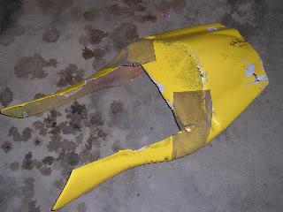

i use kaboom and a shop towel to clean and prep.
300 grit.
clean again.
lay on about 3 coats of paint in an hour (it's quick dry ****)
lay on another 2 coats or so the next day.
bout 2 or 3 coats of clear.
and BAM that ****'s hot for about 6 months then it's time to paint again.
(of course i let my bike get pretty dirty in that 6 months given that i ride street every day, otherwise it would probably last longer.)
Total: @ $20-30 + 8-20 hours depending on how much i'm painting.
Old Dec 31, 2008 | 06:45 PM
  #39
CRA$H AZ's Avatar
Squid Standers. Get Owned
Joined: Feb 2008
Posts: 1,406
From: Scottsdale, AZ
CRA$H AZ is a decent person
Re: painting question...

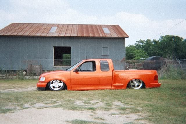

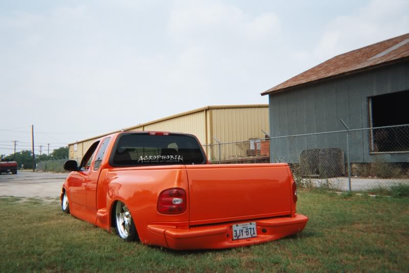

Originally Posted by SxRacer108
I paint for a living(from prep to masking to painting to buffing...i do it all), and no 1500 dry followed by 3000 wet actually leaves NO left over scratches, hell 3M even recommends doing it that way. and no xtra cut doesn't burn the hell outta anything with a wool pad, yea eventually you'll go through if you have no idea what you are doing, but sounds to me like you need to freshen up on ur products or learn how to buff...before u go callin bullshit on anyone who does this EVERY DAY 40+hrs a week, thank u
I agree 1500 followed by 3000 works great when using xtra cut compound. I have been doing this for a living for the past 9 years and the 3m reps told us to do it the same way.
btw.. I use xtra cut on every thing that I buff and the only way you are going to burn the paint is if you don't know how to buff properly.
Here is my old truck that I painted with hok tangelo pearl. The only buffing done was to nib a couple pieces of trash.
