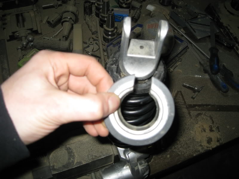

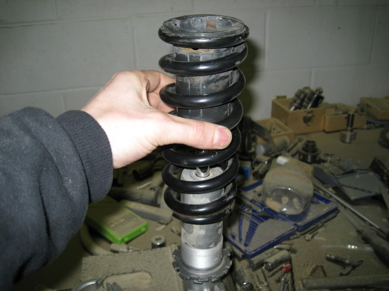

Old Dec 8, 2008 | 03:47 PM
JohnnyP's Avatar
Posts: 3,289
From: Toronto
JohnnyP is a decent person
Re: Kayaba Rear Shock 03 636
Once you get this bottom retainer off, the spring can just slide right off

Old Dec 8, 2008 | 03:53 PM
03zx6rrNICK's Avatar
Joined: May 2007
Posts: 442
From: Indianapolis, In, US
03zx6rrNICK is a decent person
well wish u would of responded about 2days ago. i posted askin how to do that. well hmm where do i take this to get it recharged and refilled with oil?
