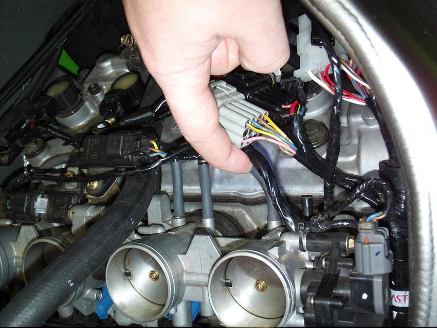

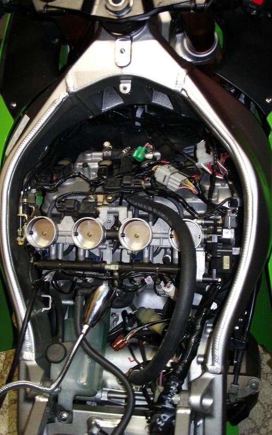

the 2 lines that were uncapped have been capped with screws.
i had another look at it all before and i noticed the bolt i put in the big airbox hole wasnt real tight.. could that of done it?
i replaced it with a tighter fitting bolt that i had to screw in but havent had a chance to ride it yet. was going to replace the plugs tomoro and see if that helps.

Old Nov 25, 2008 | 08:49 AM
Re: 04 636 weak idle?
i can't tell much by those pics but when you replaced the pair valve with the pvc t fitting there was a small vacuum line connected to the pair valve , did you plug it ?
and i doubt the loose fitting bolt had any thing to do with it but if your plugs are old that is probably the problem ..
p.s in the picture you posted the new hose for the crank case vent needs to be longer so you can wrap it around the out side of the throttle bodies so your air box will fit

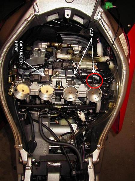

instead of capping just the one line going into the vaccum hoses i done it like how its been done in this pic. but the cap in the pic thats circled was already capped off. so i only had 2 lines to plug with bolts. is it normal for the end one to be capped off when the bike is stock?
the rest of the hoses are definatly on right and none are leaking.
iv read up on problems with the kleen air mod and it doesnt sound exactly like mine because mine doesnt fluctuate at all just has no low end power. if i never rode on idle id never know the difference.. when it was stock all round it pulled alllllot harder than it does now. might fit back up the standard hoses and pair valve and see how it runs then.
and roger that hose does usually wrap around the airbox just looks short in that pic.
i had to remove my throttle bodies when i was running a new loom could they need to be synced again?

Old Nov 25, 2008 | 05:21 PM
the clean air mod isn't the cause of your problem , the clean air mod gives you a better pull on idle and taking the throttle bodies off and putting them back on shouldn't require a sync
Old Nov 25, 2008 | 05:23 PM
see the sensor in your pic that says "cap under here" ? there are two of those sensors and one will have a vacuum line going to it and the other should be open and not capped off..........

Old Nov 25, 2008 | 07:29 PM
Dstunts's Avatar
Joined: Mar 2006
Posts: 143
From: melbourne,australia
Dstunts is an unknown quantity at this point
ahh that could be it.. which one should be open? all mine are capped off
wheres that other sensor?

Old Nov 26, 2008 | 02:10 AM
if you look at the last picture you posted the sensor that you have the arrow pointing at that says cap under here i believe thats the one that is supposed to be open and there is another sensor that looks exactly like it that is just right and forward of it that should have a vacuum line going to it from one of the throttle bodies...
try that along with the new spark plugs and if it doesn't work then put the vacuum line on the other one and leave that one open but i think i got it right
