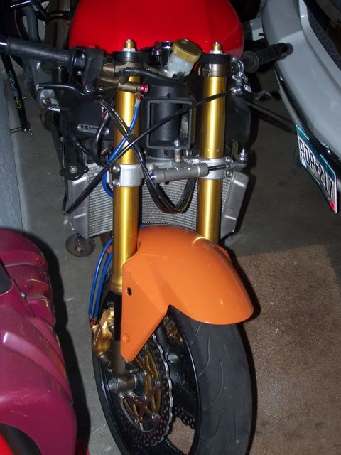

if you want to be ghetto and do it the broke-*** way you can make the 03/04 fender work...
mine has 05 zx10 forks, axle, rotors(same as 05/06 636), lower triple and a 03 wheel, calipers, upper triple and fender... you need to get aftermarket bearings for the wheel and use the 03/04 steering stem in the 05 zx10 lower triple to make it work
why would you do all that when you can leave the 03 04 636 trees with no need for new bearings in the wheel?
I got it for a price I could not turn down
