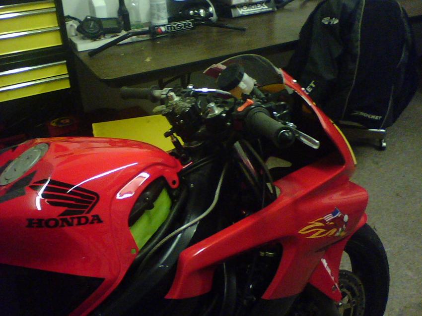

ya a fairing stay will defiantly help with that prob. is he hitting the upper cowl or the stock faring stay and gauges??

ya my levers hit the top part of the fairing stay. i even cut the fairing stay a little!

if you had 50 mm forks like a 929 you could put 636 clipons on there , the bar on the 636 clipons come out of the middle of the fork tube instead of in front like yours....
this is true! i will prob put a 929 or 954 front end on it soon anyway.
Old Nov 11, 2008 | 09:47 AM
Re: clip-ons
929 forks are longer then the 954 so go with the 929 , ho hey tripple and flipped 636 clipons
that way you can have the bike at stock height
thanks for the heads up on that roger, that makes sense, but im not a big fan of flipped clip-ons. the angle bothers me! i will prob. just run them normal!
929 and 954 forks are the same length. They actually use the same outter and inner fork tubes. On my 929 i actually had to use a 954 fork temporarily when i wasted my front end. so i had left 929 and right 954. The internals are ever slightly different though so i ended up swapping out for a full 954 front end because i found one for cheap.
