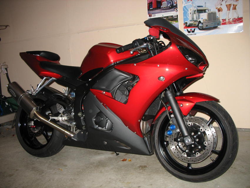

the 09 season stunt whip
just waiting for my 57tooth sprocket, SI cage and round bar and i gotta get ahold of OMR for my sub cage......only other thing is a hand brake?? im stuck on what set up to run? :YEAH

Nice Choice! :YEAH

thanks bro! anybody runnin handbrakes?? fullthrotle the way to go or what?

Stock 05 on here has the hb adapters for like $30 shipped. Than just get a line I believe mine was 56" ask someone else, newer r6 or r1 front master, 99-02 r6 rear master.

ive tried several handbrake setups as well as friends and all i can say is, HOHEY daul caliper bracket with a four piston front brake caliper,and a brembo 16x18 handbrake or the magura handbrake is the best in my op.
i run a brembo myself with the hohey but tried a friends with the magura on a r6 and it was unreal!!!! magura first if ya got the loot,if ya wanna save a buck go brembo,or find a brembo gold master on ebay from a ducati.
i know the MONKEY TACTICTS crew all use the brembo golds from ducatis and they love them to.
if your learning,in my op hohey is the best,beacause ya dont have the foot to handbrake fade that adapter systems have.

It is an exhaust If you want to stunt your bike is not going to be unharmed!
k-dog I would take that exhaust off your r6 sell it and get a stock one and cut it down.

i just got a shorty off my buddy today... im ready to rock it now....i tried some slow **** the other day.way differant than what i was used to...nice and snappy with a nice balence point. but i wanna get my cage on before i try anything to crazy this bike is mint and i dont wanna bust a case cover the first lot ride lol

I would wait till you get a cage enough stuff gets broke even with a cage and that is a nice bike! But hey that's just me.

if you have done any staggered wheelies on this bike yet note the way the tail plastics keep you from getting your foot on the peg square ..omr subcage fixes that for you

+1 It rubs against your leg with stock peg brackets rubbing the skin off your leg, that **** gets annoying after a while!
