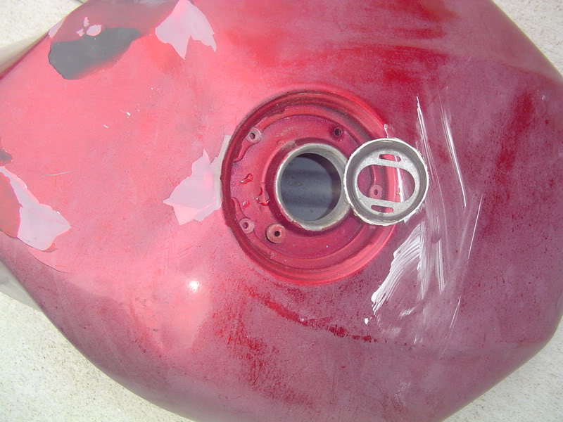

just cut it out before you dent it and pull it out through the fuel pump hole

Re: 636 gas tank splash guard
wait till your done denting it then just cut as little as possible
Just enough to be able to fill it up? If I cut too much will I end up leaking gas out everywhere?
Old Oct 17, 2008 | 03:17 PM
mine looks like millers ,just try not to get too close to the top

it can be done after the fact
^+1 i have 2 tanks the 2nd one i have was already dented with the splash guard in.. just used a dremel.. and took it out through the fuel pump

You just have to watch out for the drain tube that runs from under the cap area through the tank and out the back where the black hose attaches....If you look aournd the cap area there is a little hole on the left side, thats the tube...So when your cutting on that side try your best not to go to far cutting into the tube thats inside the tank...If you do cut it anything split ontop around the gas cap (like rain water) will mix into your gas tank, and when you wheelie gas will **** out....
Leant that the hard way, bought a used tank that was already dented and had the splash guard cut out. And whoever did it cut the tube, so rain water was getting into my tank and gas split out.....I plugged the hole and everything was good, but from then on I knew to watch out for the tube when cutting the splash guards out..

It looks like TL MILLER cut most of it out, can you even cut anymore out?
Thanks man.
Old Oct 17, 2008 | 06:17 PM
Thanks man.
no need to cut any more then that out
