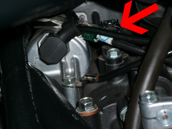

its been said many times but ill say it again... you MUST unplug the speed sensor for the idle to work correctly. you will loose your speedo but its easy to connect and disconnect. here's a pic of the connector below, this is the left side of the bike.

i did do that...still acts funny.

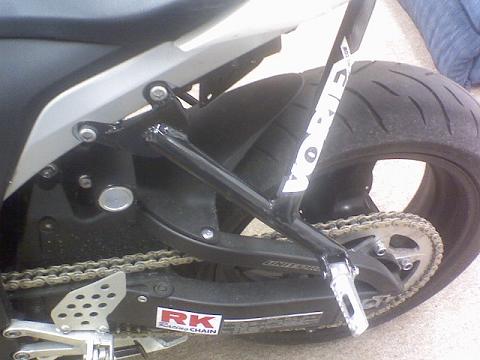

i took thre upper off of mine and put a db set up on it. after that the idle was fine. im not sure what fixed it... i thought it was un plugging the speedo sensor. also.... the omr subcage is a must for this bike, dont bother stunting it without one!!!

damn, dunno what the problem could be because mine rode fine once i unpluged the speed sensor . i would re-check your work around the airbox. could have missed a plug or hose after putting your idle cable in?
im learning on my 07 still but heres a few thoughts...
*must unplug speed sensor after installing idle cable for it to idle correctly. also reduces the engine brake at slow speeds.
