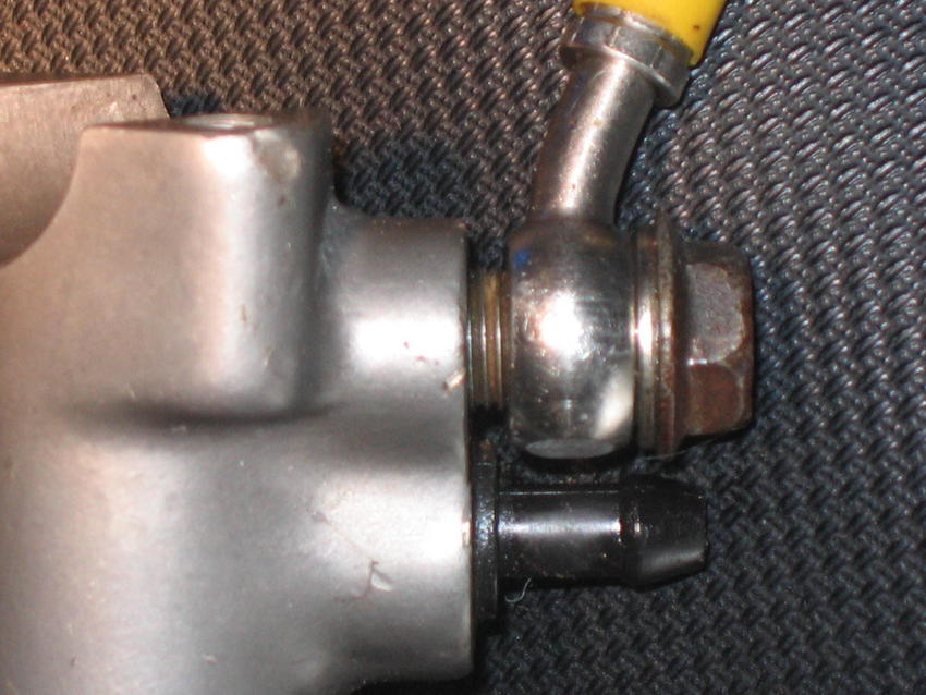

The screws are the same thread/pitch and will swap out.. I'm wondering if this is possible, for better clearance while putting on my HB?
It looks like the banjo is a tiny bit too long.. could i cut a few threads off or shim the banjo out? leaving on the road for work for 15 weeks tuesday, want to get some riding in before then.

haven't been riding yet, just got the brembo in the mail from a friend today.. I tried searching, but if you type "banjo" or "bleeder" or any variation of those, it comes back with a fuckton of irrelevant ****.
I already swapped the screws after the first post, but it *looks* like there's too much of the banjo exposed bc the bleeder hole tapers off and the banjo doesn't.

ya its missing crush washer, but still looks too long...
so ******* add another one or grind the bolt down (just make sure you clean it thoroughly before re-installing it).

is stacking crush washers ok? thought it may lead to leak in the system.
I wanted to shorten it, hence my asking in the first post.

Are you sure thats a FINE thread pitch (1.0 pitch) banjo bolt? It looks like a 1.25 and that will **** up your Brembo if you tighten it.....The brembos use a different bolt thread pitch then most other brake parts....

It's the one that came off the lever..
i don't see why it'd thread in all the way and then bind up if it were a different pitch...

hm. maybe this one's just long for some reason? i'll try and pick a lil shorter @ the store up and see how it goes. Hoping i can ride some sunday/monday.
