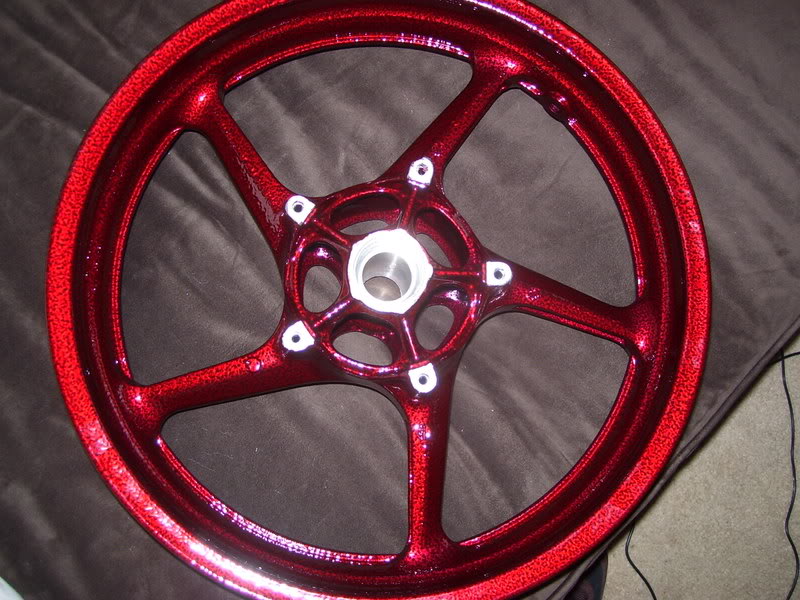

mine came out pretty good...
theres probably a sand blaster in your area. see if they do bead blasting. its less abrasive
btw, i def. didnt do the rims myself. lol

those rims look sick.

thanks, theyre spider veined, and candy red. you should see them on the bike. hell you should see the bike when its put of the paint shop. lol

thats silvervain with candy red over the top.....
i was powdercoating for a shop for 2 years....the trick is prep just like painting it has to be clean. prebake anything that has grease on it.like a rim...bake it at 400 for a few minutes to get the grease to burn off.then blast it,blow it off,and coat it.

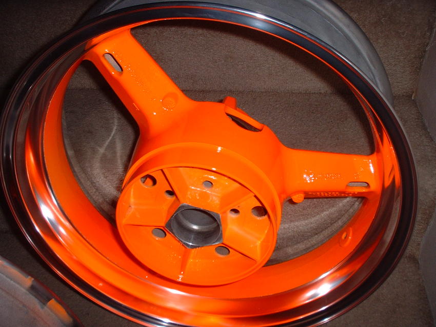

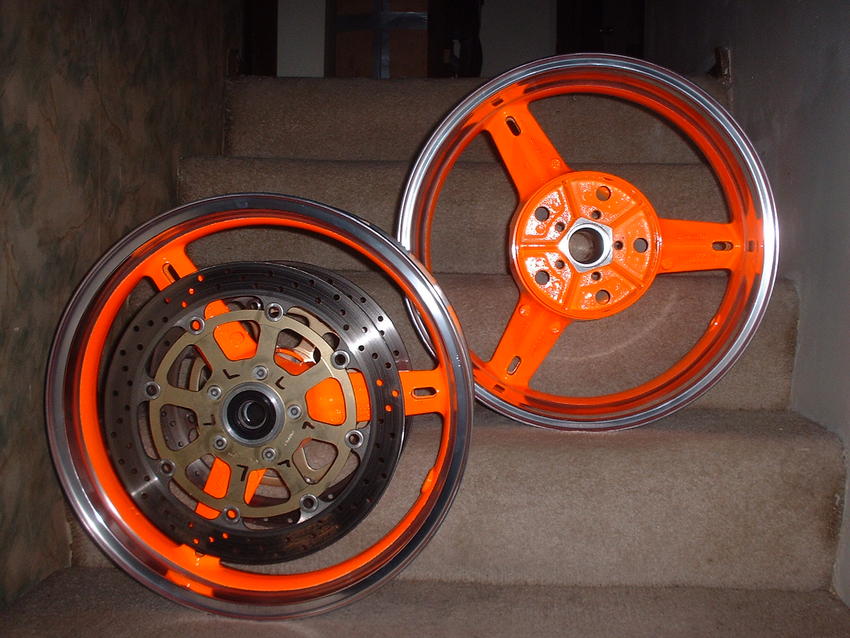

My first set of wheels I coated..... these were a nightmare, but if I had to do them again I could do them alot easier..... learn from your mistakes!
ID:	211156   Click image for larger version
