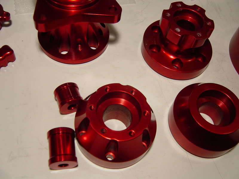

Here is a perfect example, I had a bunch of parts anodized...Mostly 6061 and some 7075 sprockets. I also had a forged part and I just wanted to see what would happen to it when anodized....So that part was done at the same time as the rest and you see for yourself what happens when you try to anodize forged parts...
These are the misc 6061 and 7075 parts I had done in red and black ( I polish the parts first, to give them that deep candy gloss look)...

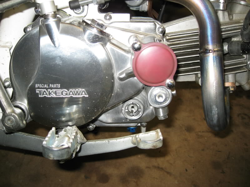

And this is the one forged part that was done at the same time, as you can see it was supposed to come out red but it came out pinkish/grey...And it actually looks worse in person!

If you want the anodized look on forged rims you need to look into powdercoating them with a translucent colour...Either polish them first or lay a chrome or metalic silver base powder coat, then clear over with the transparent powder colour of your choice....
