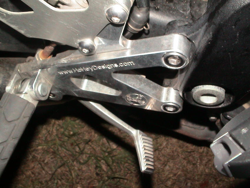

buy hoheys rear sets and you wont have a problem:YEAH

I would buy those if I didnt have to buy two tires and a new brembo lever! Just dropped the rear set off at the welder, stuntin tonight!

be careful on them after they get welded,,,,,after aluminum gets welded it become way more brittle.....save up and get some hoheys.......you'll love them

true story... after my stocker broke twice, i bought hoheys.... beat the hell out of them ....for some reason my vortex pegs always seem to dig in a little bit...... and never had them show the slightest amount of bend
