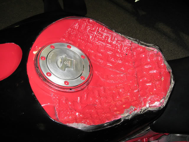

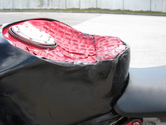

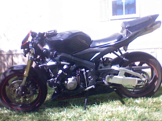

he didnt have a heat gun so he cut a hole in the plactic for the metal tank to come through, and later glassed the back plactic so it had a better lip.

that looks like crap.........

hahaha it did look like *** i was just throwing a idea out there, you might be able to make look good if you know how to work with fiberglass. im just glad it wasnt my bike .
OUCH! wtf was he thinkin he should have borrowed a heat gun! i gotta tank cover red/black $120 shipped
