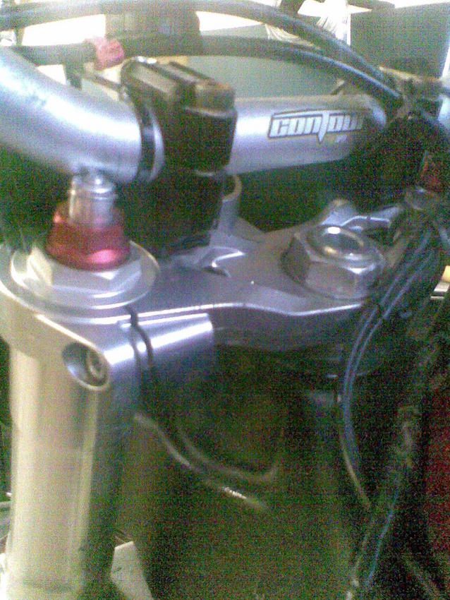

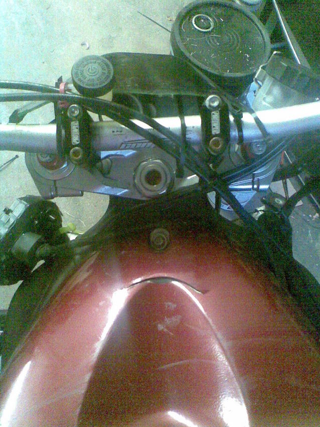

Re: 05-06 zx6 db bars?
stock will work just move ignition. shitty pics. and this is with protaper risers
ID:	209377   Click image for larger version

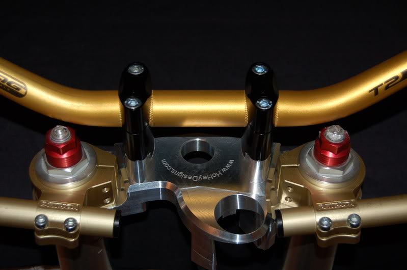

Old May 10, 2008 | 01:04 AM
Ho_Hey's Avatar
Posts: 1,626
Ho_Hey is a decent person

so gangster but its not letting me view anything on your site.
i tried boring the 03-04 clamps and my f*cking but is super dull so im gonna try and drill the smaller holes in the stock one. if it dont work ill either buy the hohey or try getting a better bit to drill the 03 clamps

I have that exact Hohey Set up and I love it.
