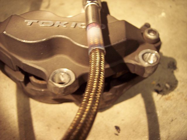

Alright I finally got it done. I made my own dual caliper brackets for the 636. You are able to run both stock calipers or a four piston caliper. Heres the deal. If you run the four piston caliper you have to massage or grind the caliper a little bit to get the best contact patch. and theres no other way around it period. the four piston caliper is to thick and will either hit the wheel or you wont get the best contact patch on the rotor. i will post up the pics i have taken to show how much contact i got and what i did to get it. If anyone is interested i will have them avaiable for 125. send me a pm with any questions.
ID:	209026   Click image for larger version

So lemme get this straight... you are using 100% of the f4i 4 piston caliper brake pad's contact patch?
Is the 125 shipped with the 4 piston bracket? Or can i use the ho-hey one that i have?
If you can get me this by the weekend, let me know, ill take one (ill pay a little extra for shipping if you can be SURE its here.
no! dont you see the top of the pads, its uses just as much as the hohey setup! its not possible to use all the pad, the rotor is not big enough why are you looking to buy this if you already have a hohey 4piston setup anyway? not hating just wonderin

easy killa...I saw the picture. but the left one looked untouched, and i couldnt really tell on the right one. I didnt understand why you have to grind the caliper, and figured that by the sound of his description, that he is using more pad than hohey, and thats why the caliper had to be modded

looks to me like he is using about 99% of the pad

I kind of wondered/am wondering why HoHey didn't make it so that the whole Honda pad made more contact on the 636 rotor... Is the caliper the issue?
I contacted hohey long before the honda adapter ever came out, asking if they would ever make a 636 dual caliper bracket with a front caliper setup, and they said they had absolutely no plans for it.
To me, it seems like they just kinda threw this adapter setup together real quick. Their original bracket im sure works great for the 2 stock 636 calipers, so the adapter was just an afterthought... thats my assumption anyway. I have one, and havent really had to chance to use it yet.

yeah the caliper hits the wheel
