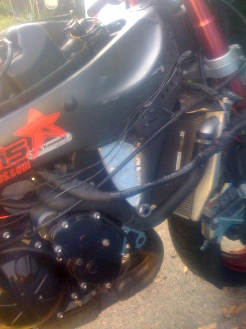

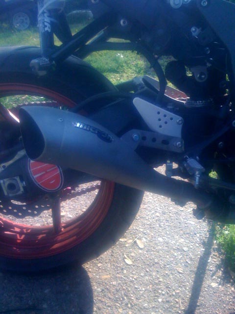

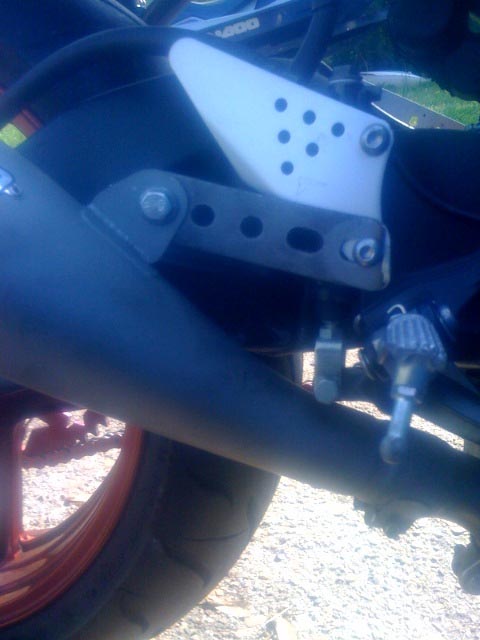

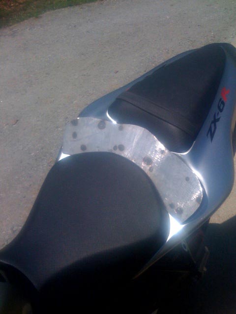

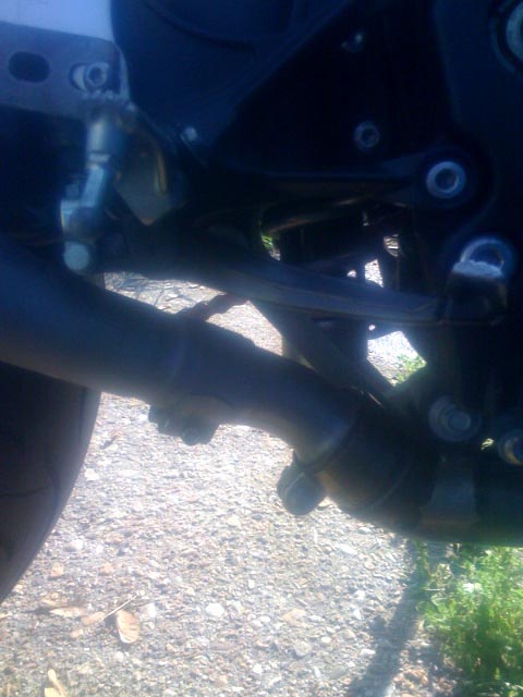

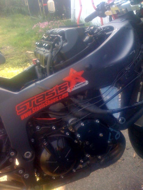

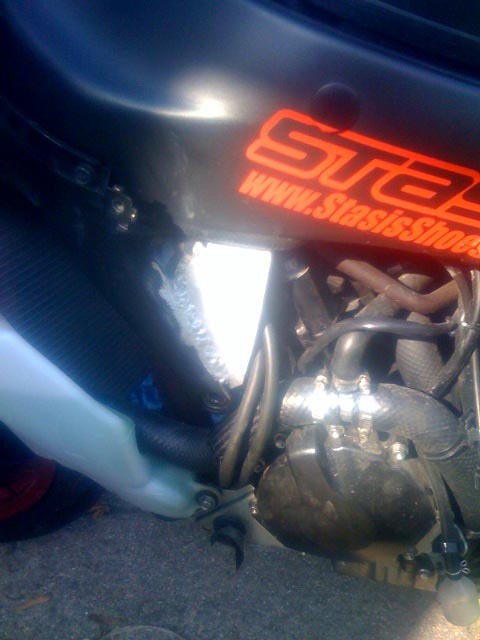

here are the pictures i promised... this is the new stunter i will be rocking.... we are putting it together as we speak... and for the people who asked how to do the micron exhaust mod that me and kj have done the pics are there also...if you need me to explain in detail let me know... but you pretty much remove all the undertail piping and get a muffler shop to bend a 8 inch pipe to a 20 degree bend and expand one end to 1 3/8th and the other to 1 7/8th and it fits like butter baby....
and it works on any bike...sounds mean as **** and looks the business... i figured i would switch from undertail and go custom
we are going to make tail savers for 03-08 zx636's and for 00-2008 gsxr...also honda 600rr 03-08...ours is made of aluminum not steel and will not flex at all.... the raw version is on my bike... but we can powder coat any color or surf board pad it up for you ...100 bucks
also i have custom sprocket guard that will be free with shoe orders over 100 bucks....starting in mid may....
as we finished putting the bike back together... i will keep adding pics :YEAH

what is that on the exhaust???back strap? get a little billet aluminum dog bone or something

lol... i like the iphone better... but your cam takes better pics for sure... and the bracket is temporary... i have a billet bracket with the stasis logo being lasered into it
