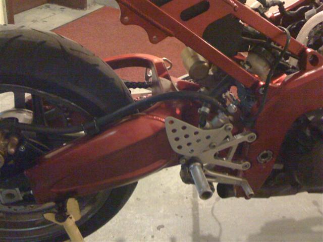

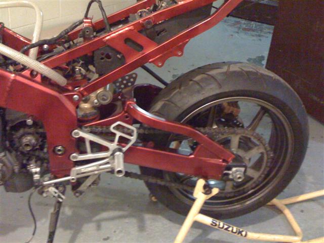

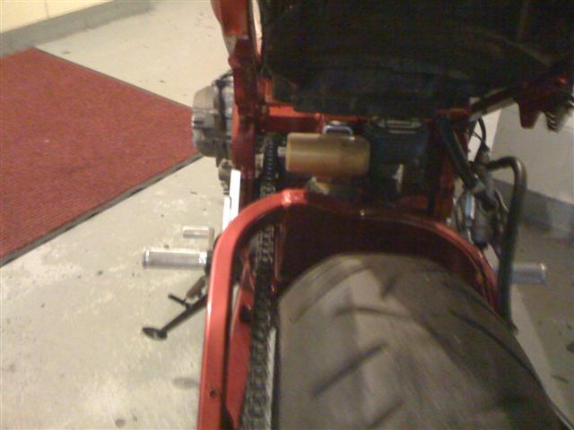

Old Apr 9, 2008 | 02:34 AM
babyJOKER's Avatar
Posts: 1,281
From: Milwaukee,WI
babyJOKER is an unknown quantity at this point
Re: broken 04 636 rims
pics...

Originally Posted by DoubleSustanon
pics...
what kind of rearsets are those?

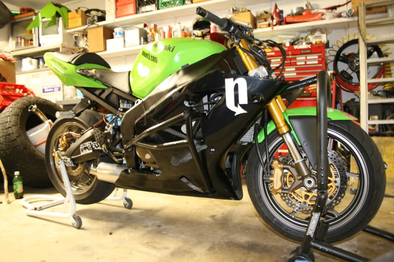

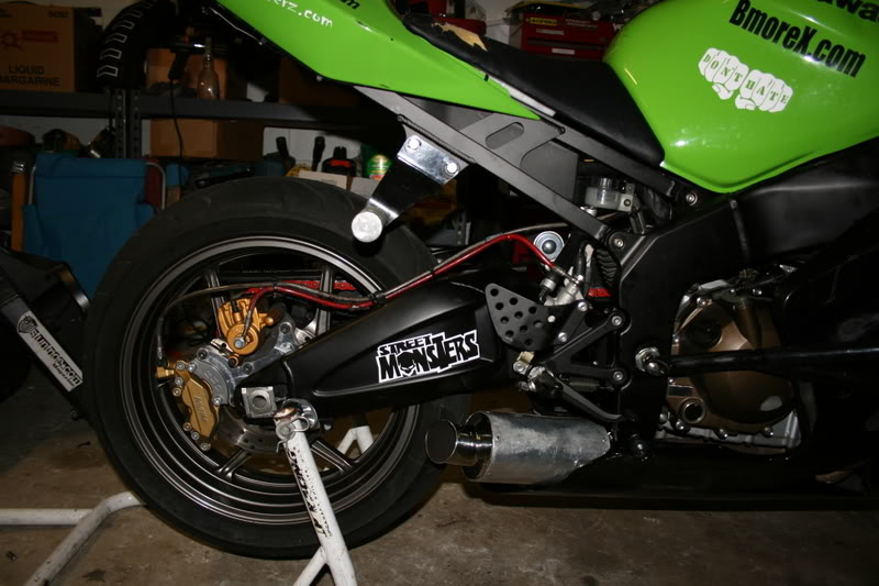

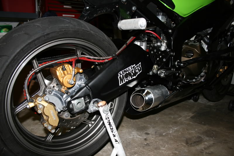

you need a 05-06 spacer plus the 03-04 spacer on the right side of the 03-04 swingarm or just do the whole conversion
looks like good oll c&m woodcraft's i have them on my f4i and i loved them
yep...:YEAH
