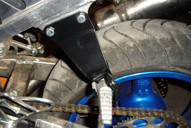

Just get the adapters if you want to run folding pegs
