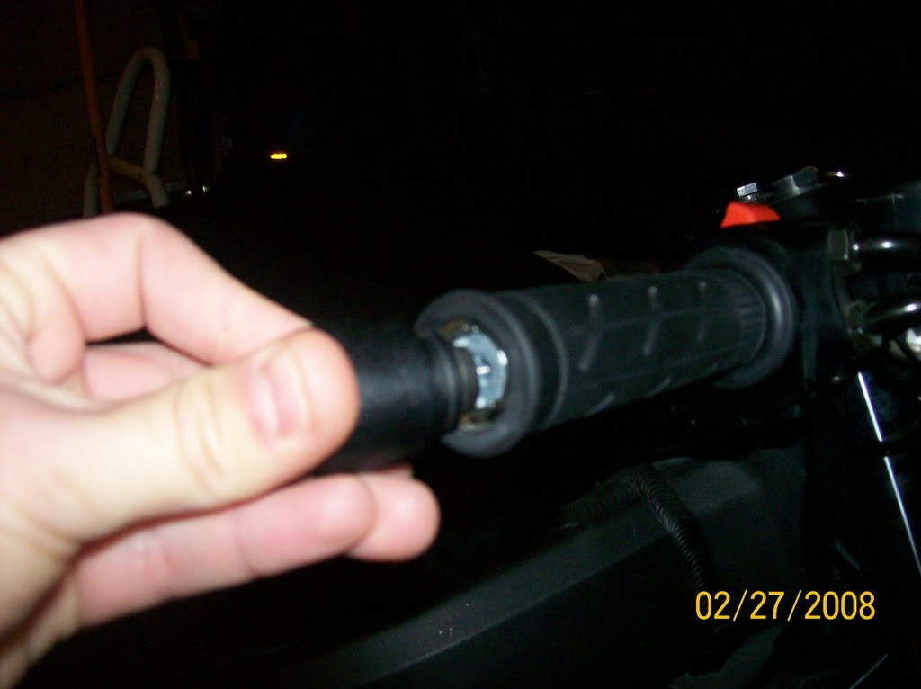

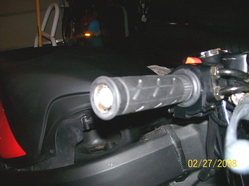

One more question , what about the bar ends they don’t fit back on when you flip them ?
Thats odd the bar ends should fit without a problem make sure you have those notches lined up.

I thought so to and I cant figure it out it doesn’t make sense but it is what it is , and that is they don’t go on. I don’t know if you can tell in the pics but the clip on’s go all the way to the end of the grip.
