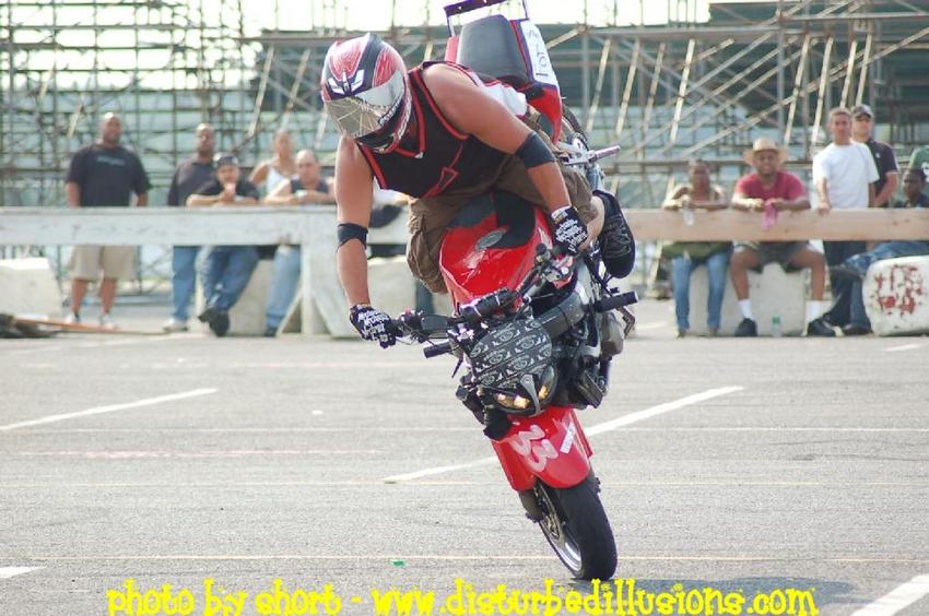

well if your at balancepoint and your actually riding a endo , steering is done by applying pressure to your handle bars...pushing down on one side and letting up on the other..ex. if u push down on the left clipon u will go left, right.u will go right............
Name:	July Fry (173).jpg
ID:	206376   Click image for larger version
Name:	July Fry (213).jpg
