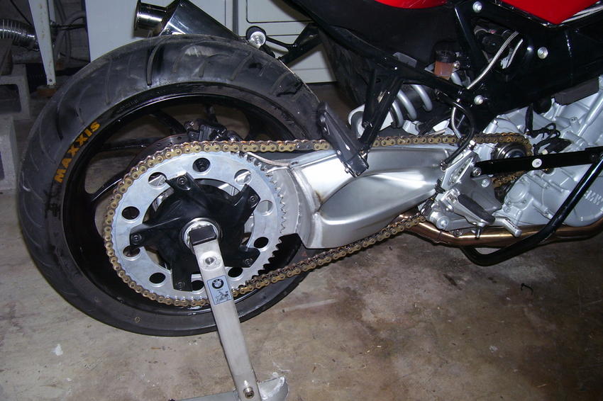

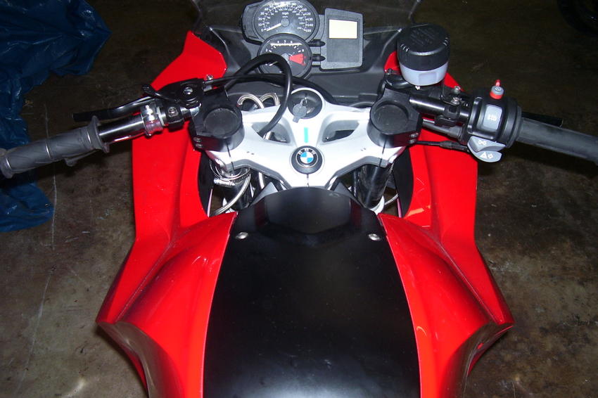

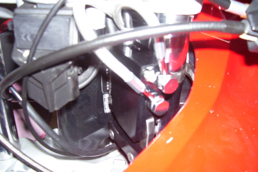

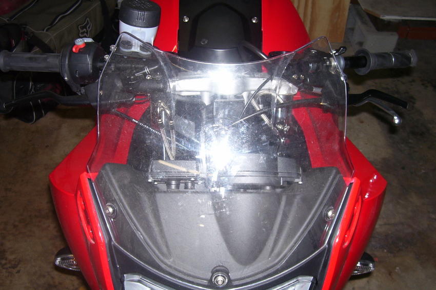

Since the last thread on the new Full Throttle Inc handbrake system was a bunch of bs, I thought I'd post my own experience installing the new system as well as a little feedback.
I included some pics as well....
I read the instructions twice and then followed them precisely as they stated. I didn't have any problem getting fluid to run through the whole system within 30 minutes of opening my package from Bill. I found it pretty easy to route my lines from the rear master, up to the FT master on the forks, and then back to the rear caliper.
The one suggestion that I will make is to run your lines and mount the remote master BEFORE you start bleeding the system. I started bleeding and when I was done I had to take the lines off the system in order to mount it in a position that would be unrestricted. Other than that, I had no problems.
After I remounted the system and routed the lines where I wanted, I re-bled the FT master and the rear caliper. I had pressure for sure, but there was definately air in the lines, so I bled the system three or four times per available bleed point from the rear master up to the remote master and back to the rear caliper. It felt better but was still spongy so I took a few laps around the neighborhood using the brakes and trying to pump them up; and then I re-bled the FT master at the bleeder valve 2 times and the brake was right there....pretty much just like the instructions said.
The strength of the hb system is great! I have it on the 2nd easiest setting and I could stall the bike out with the clutch out no problem with a squeeze of one finger.
I haven't done any wheelies with the hb because I haven't even ridden the bike and I was in my neighborhood, but I clutched up a few sitdowns and the foot brake was great and the hb worked instantly afterwards (in a straight line) without any pump or lag. I'm super stoked to be able to try this thing tommorrow and will report my feedback.
I don't have everything setup completely right now. In the pics, things are a little tight. I'm either going to slide the remote master down the left fork tube more or relocate it to the right forktube (keep in mind it was late on the west coast when I was doing this!) The clutch lever is stock bc I need new clutch cables to mount an ez pull. The hb lever that Bill sent me is great and will work perfectly with an ez pull. From the looks of it, you will be able to get the clutch/hb really close together...much easier than a brembo/ezpull.
So, in the end, I'm really stoked about this product! It was easy to install and clearly already is superior in performance to the brembo/FT/ezpull system I've used before. You can adjust the strength of the handbrake very easily with only an allen wrench, and you can also install more than one hb on your bike...although that's not my style.
Here are the pics, not great; but i'll get some more posted when I ride the bike and relocate the remote master.
The introductory price right now is $300 and I'm pretty sure that they are going to jump to around $400 within a short period of time. I've used dual caliper as well as Brembo/Full Throttle adapter/ezpull (with the FT master being what I've used for 4 years now) and I'm not sure you can even get any of those setups for $300...maybe, but I guarantee they won't work as well as this setup, or have the versatility.
This is certainly a new age in the HB world and I can't wait to see what some of you crazy fools are going to do with the possibilities this thing enables!!
Thanks Bill!!!!!!! www.FullThrottleInc.net
That's my first hand experience with the new setup, here are the pics:

I helped someone put one on an R6 today and have to agree that it would be wise to route the lines and mount the remote master before you lock all the line down. We ended up having to get fairly creative with the lines afterwards. The thing works awesome tho...better than the foot brake from what I saw.
