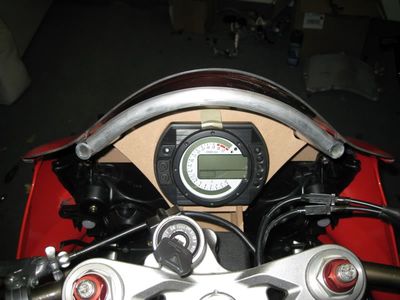

Ok guys I got really motivated today and just finished designing the 05/06 stay, been here 12 hours straight but its finally done. My new CAD/CAM program made it alot easier to get the parts drawn up and fitting properly, used to spend a few days doing this....
This is what its going to look like, the MDF will obviously be replaced with plate aluminum. I use MDF for the design stage then from here I have the same shapes cut out of aluminum sheets for me..
Im going to try and get another die made for my bender to try and match the cross bar to the windscreen a little better, for now thats the best I could do with my crappy bender and limmited dies...
Im really happy with the way I was able to support the headlight, it will have the 2 top mounts that are pretty strong(much stronger then the 03/04's). And also 2 more bolts that will mount right through the top of the headlight housing..Just like my 03/04 636 stays these add up to a very sturdy upper/headlight setup....
For now Im happy with it and hopefully when I get the parts cut out of aluminum after Christmass, everything fits good and I dont have to make any major adjustments...Let me know what you guys think

Old Dec 24, 2007 | 04:26 PM
  #77
da Liks's Avatar
Posts: 4,142
From: Rotterdamn Europe
da Liks is a decent person
Re: 05/06 636 stunt stays, need some input from riders.
looks sick...
