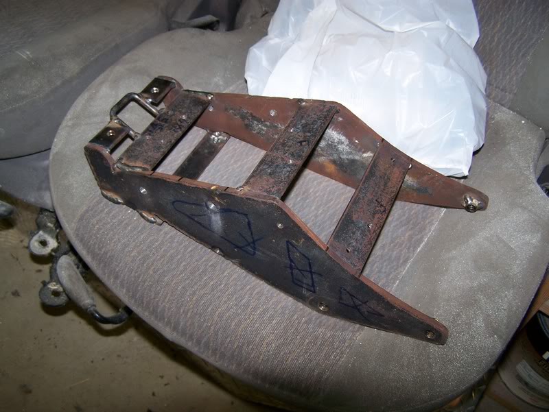

Tandem Designwurx makes the upper and lower subframe sections for the K7. This is a pic of the upper without paint. everything bolts up stock and they are solid as hell! powder coating is available.

holly **** that looks like a ****** cruise ship anchor
1/4" steel plate ??? do people try to take out stunters with ied's where you live? thats only half of it too with the other half you would have no choice, but to make whoolies everytime you hit the gas.

[quote: drgnazz: but it won't break]
hell no, that thing would chip California off into the ocean before that happens

that was the first mock up. they are now laser cut out of 3/16 and the brackets are 1/8. the lower is 3/4 square tubing and 3/16 tabs to mount the upper. and if you know how to use your rear brake then you have no worries about breaking the frame tabs off. plus our cages have links that bolt onto the lower sub rail, eliminating the frame tab breaking issue.

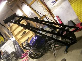

Re: Gsxr 600 K7 12 O'clock bar
05 gsxr hooked up.. took about 3 hours of work.. made for a buddy that snaped his stock in half
bro, fab that **** out of aluminum, steel isnt going to give the tabs a chance in hell. half of the ******* on here dont know how to use the brake, because thats hard to learn when your fingers are attached to a keyboard all day.
looks like you hacked up a dolly and bolted it to your bike in the first pic
UPS left it

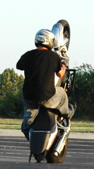

I have been runnin a steel sub on my 05 for over a year and havent had any problems, I have sold quite a few for the K5 and havnt had anthing but happy customers. each to his own I guess.
