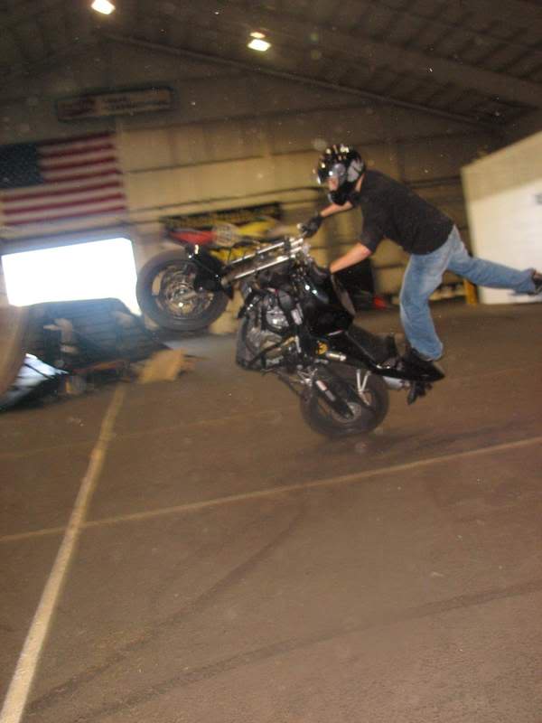

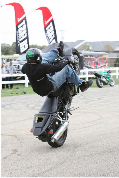

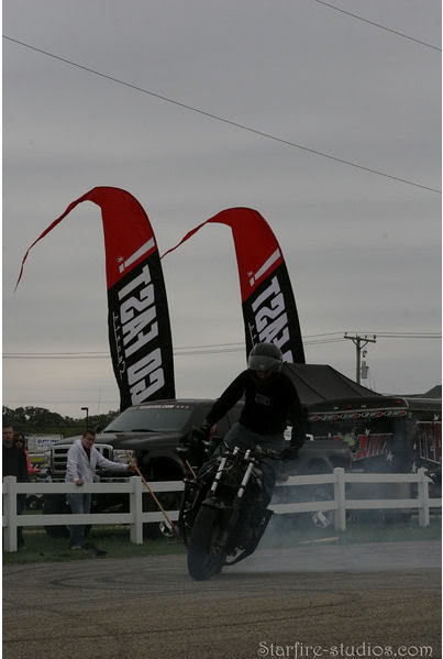

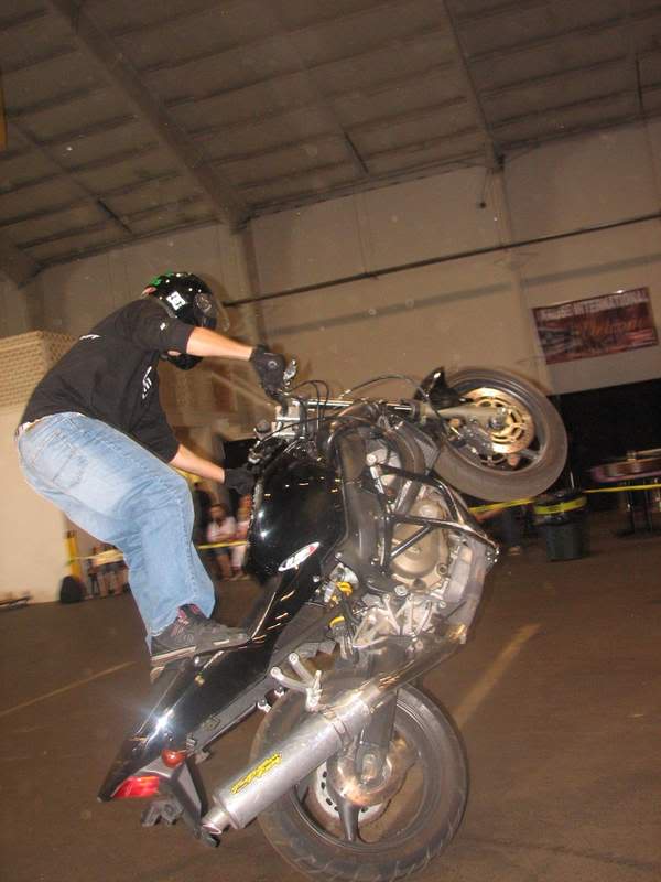

and yes for all those who are wondering i am still riding here and there. mostly light practice and shows.
But im still keeping a strong 2-3hour a day regiment of call of duty 4 on xbox 360 live to keep me out of trouble.
