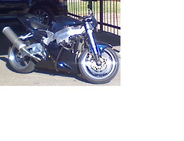

yea dont sand the frame ... use paint stripper put some coats on it and repeat till its all gone... then use some steel wool 00 then 000 then 0000 then 00000 something like that its the finest you can get and sand in a cross hatching not up in down or side to side.... this is my 954 after i did the wheels and the frame. however not the best picture took it with my phone..... also check out this link its where i learned how to do my stuff and worked out great.....
http://sportbikeguy.com/garage/floor/rimstrip.html
