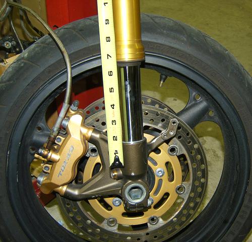

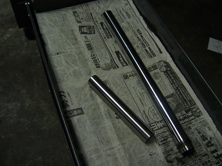

John and Roger, we must think alike. Nasty left his 636 at my shop for the week and I was really interested in this problem. About 4 years ago I made a 954 front end fit a 2003 sportster 883R. I only used the fork legs and retained the factory front wheel and fender. In order to do this I made billet axle clamps (complete with the proper damping adjuster) and used radial calipers as back then they were just coming out on sportbikes and were kind of a big deal. Naturally I had to make upper and lower clamps for this all to work but that's besides the point. In doing so I got to know my way around the inside of various forks pretty well because the 954's were too short so I ended up using other KYB or Showa forks before I ended up with a pair that fit my needs.
So anyway, short story long, being interested in this problem I disassembled Nasty's forks and found that there is indeed room for a steel sleeve to prevent the lowers from breaking. I installed a cnc turned and ground sleeve and it worked out great. It goes an inch and a half down into the axle clamp and nearly 4 inches up into the top slider (that's with the fork tube off the bike). I used a 3/16 side wall to ensure it would be stronger than it has to be, but didn't want to go any thicker than that with an eye towards weight (the sleeve adds 2.3 pounds to the assembled fork). I've been working on this since he'd left his bike here on Monday but it's been worth it as I believe this solution will completely eliminate the incidence of a lower tube snapping and is much more practical than replacing an entire front end.
I hope you guys don't think I scooped you, I initially began disassembling the front end with the idea of turning and grinding a heavier lower slider, but due to the limited clearance at the top of the tube (due to the damping components and the bottom of the spring) a precision sleeve just made more sense.
I'm offering this service to the public here:
http://www.fullthrottleinc.net/store...roducts_id/198

so basically its reinforcement of the tube.....thank you bill when i go to rebulid my bike....this is a must have mod:YEAH

might cost you a bit extra $$$ in shipping and a little extra time... but seriously, isnt that worth your life... (or preventing a nasty crash and hospital time)!!!!!!!!!!!!!!!!!!!!!!!!!!!!!!
sucks he is far away, but still MORE than worth it!!!

I read what john legion wrote" Is the sleeve going to stop from the fork tube from seperating from the lower fork leg? or is this just going to prevent the tube from breaking in half?
I know on the 03/04 tubes both situations have happend.
the reason some get loose is because they were not threaded all the way down so this will take care of both problems because im sure bill will get them tight and use some sort of thread lock along with the sleeve to keep the tube from snapping
