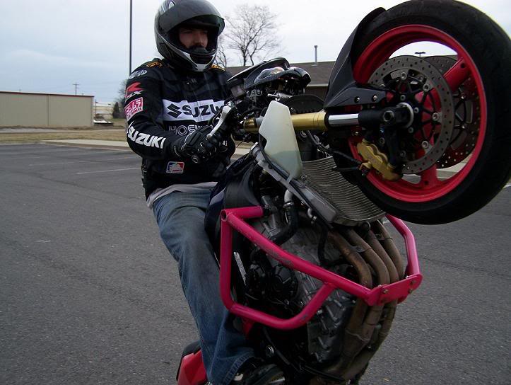

I made mine myself, havnt had any problems. 1.25 od mild steel, 3/16 thick.
