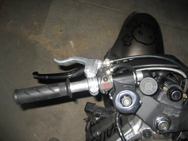

just set it up two seconds ago...use to be shitty....and a bad set up could hold you back so spend time and money to get it right

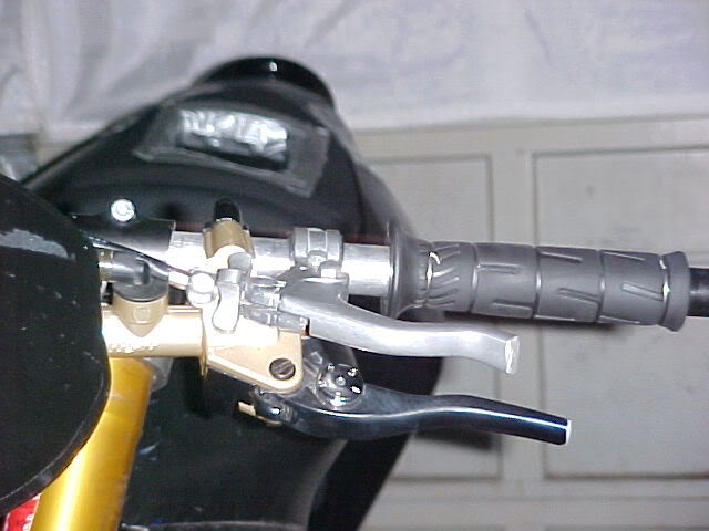

i love my setup!!! the billet 16x18 clutch master is the sweetest feeling master i've ever felt and bleedig it is cake
