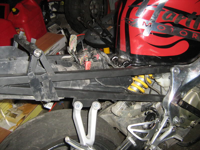

Any one else here build a 12bar heres mine

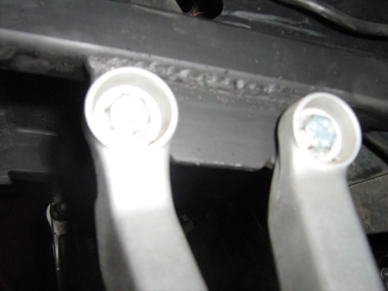

Well i got off my *** today and build my 12bar here is a few pics total cost 25 dollars in steel and a few hours of time and probly 5-10 bux in wire and gass for my welder
2 1/2 x 1/4 sides with 2x 3/8s endplate may add a second replaceable 2x 3/8s back plate
What you think?

Nice Job. What's wrong with your exhaust can? your dog ate it off??

Looks nice. I mad a homemade one just like that with the 1/4 cold roll but it bent after a while.

well it had a bit of scrapage before i shortend it and well i welded it back together a little twisted and did not notice till i had about 2 inch of weld done and did not want to cut i off and fix it might do it when the snow hits

yeah i should have did a 1/4 twist for added strength but it should not bend had enuff 3/8s but the 1/4 was heavy enuff
it is 1040 steel grade one grade before high carbon/aka spring steel

not bad. i hope i don't see that thing bolted in the stock subframe bolt hole...if so, knock that **** off, it'll break super fast. drill the subframe and use 3/8" hardware to hold it nice and firm.
all in all it looks good, i wouldn't have angled it so high though, i like mine at the level of the rear seat or lower so if i go over in a stoppie i don't get a bar in the back, i get a rear seat. just a thought.

It has 2 grade 8 3/8s bolts on each side where i drilled the sub and bolted it there just under the tail plastics
