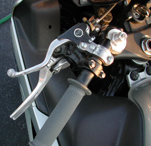

Put them below the triple like mine
I'll post a pic in a min
Old Aug 10, 2007 | 01:44 AM
Re: more comfort in a hc???
Just move 'em farther underneath. I have it mounted on a bracket that I mad that connects to the bolt that holds the triple to the forks

but how do you keep the pressure....... ????
when mine are below the master i loose pressure??

Well, be a normal person and put it on the bottom?
As far as pressure, I've never had a problem..

but your resivour is still ontop your master even though its mounted under the triple...
so that doesnt help me!!

dude. you have to bleed your whole system with someone holding the resivour on top. once its ll bled out, overflow it then seal the system. once the system is sealed you wont lose pressure no mater where your resivours are.
Old Aug 10, 2007 | 01:55 AM
In that picture it may look like it, but my reservoir is definitley lower
