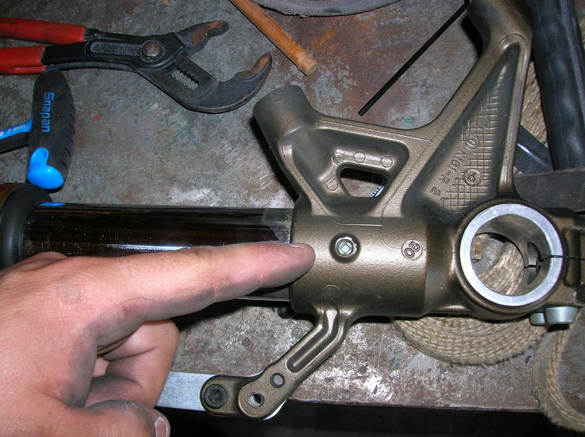

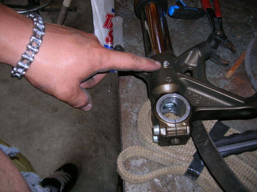

HERE IS A CLEANER PIC.TURN THIS SET SCREW OUT & TIGHTEN THE SLODER TUBE.I TRIED A STRAP WRENCH WITH NO LUCK SO I USED A THICK RUBBER STRAP AND A 16" PIPE WRENCH..

05/06/07 forks do not have this set screw because they are built by showa, 03/04 are built by shitty KYB..
So you gotta use alot of force to have it fully seat then tighten the set screw? Or can you just loosen the set screw, twist the inner into the sloder(is this right) tube, re-tighten set screw. You tried a strap wrenech with no luck of what??
