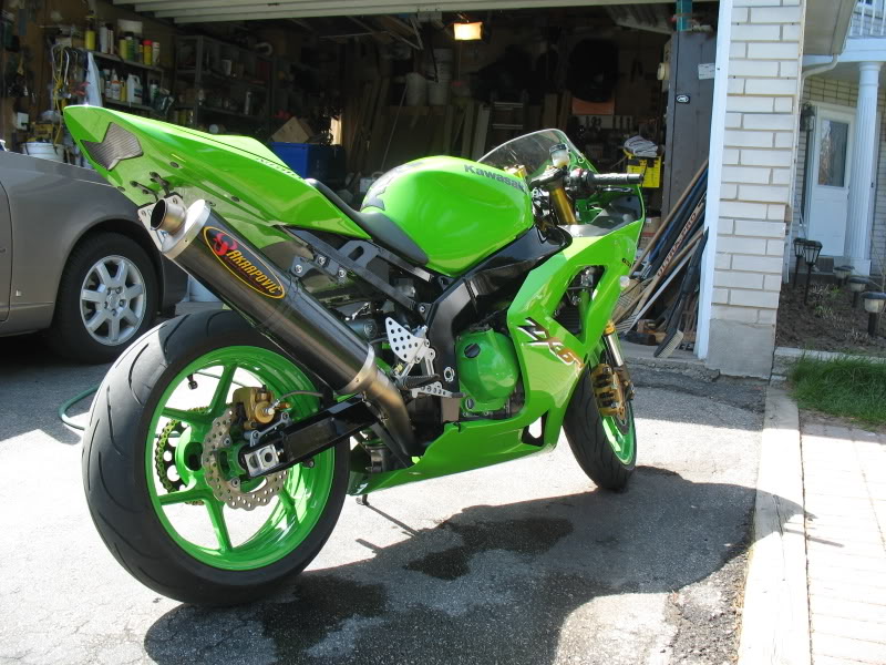

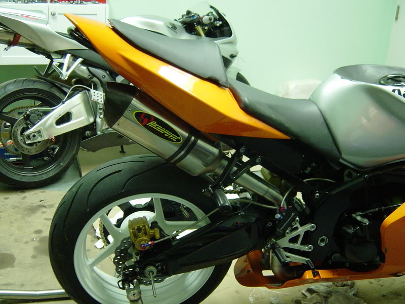

Hey weren't you the guy that put an 05/06 rear wheel in an 03/04 swingarm??? Pics?
Old Jul 12, 2007 | 03:48 PM
JohnnyP's Avatar
Posts: 3,289
From: Toronto
JohnnyP is a decent person
Re: 636 fork swap?
Originally Posted by Hazen
Good info Wheeliest.
I would be the first to do that as far as I know, did that more then a year and a half ago...Because when I asked on all the Kawi fourms everyone said it was not possible without the 05 swingarm swap....But Ive done it both ways
