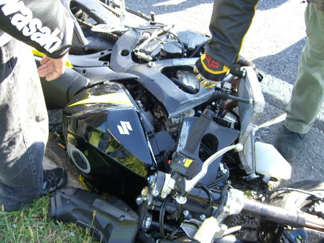

Old Jun 14, 2007 | 05:13 AM
Re: OMG need advice....Please help!
i here it's not just the old gsxr's
Originally Posted by ImBusaBad
