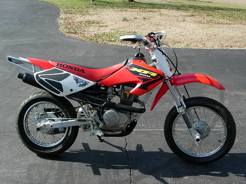

Crazy D has the right Idea...except a good fabricator can hook you up with both foot and handbrake.... look close at my pic..(not that Im a good fabricator...but I get the job done...hehe).. I fabbed an extension onto the brake lever comin out of the drum....then Added a handbrake line..... The HB cable is held back by a bracket that bolts to the swingarm (pinches the swingarm) and it can be slid forward or rearward to adjust the brake tension. (you still have the adj at the lever too..... good luck dude....keep rockin it !!
