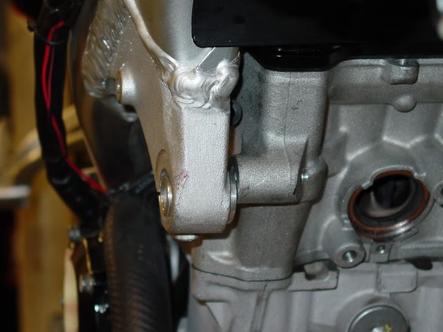

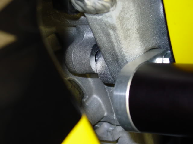

Size:  48.9 KBName:  750in600ls.jpg
I'm pretty sure this is the delema you have? both front mounts dont line up?
go read up a www.gixxer.com LOTS of engine swaps done there. some guys leave those two bolts out others rig something up. Or sell your 750 motor and get a 1k.
