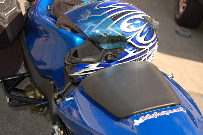

Just got back from the ATL late last night. I'll post up some ATL picts later in another thread but here are two good action shots of the HHD dual set-up's in action. "Red F4i" Darrick Atlanta freestyle "Blue F4i" Chris Extreme Therapy
