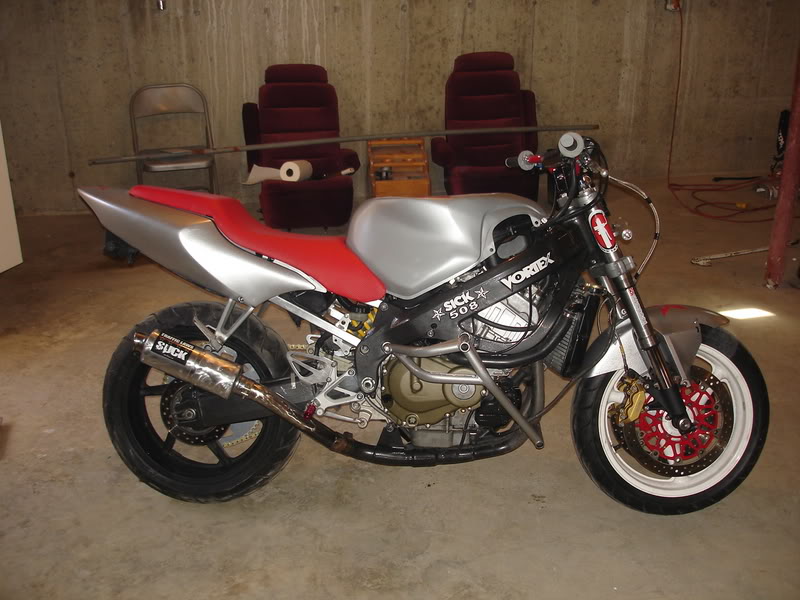

dude , i had 900rr rear rim on my f4i for a few months.....900rr will fit into f4 & f4i swingarm directly same as F4i or F4 ) everything spacer is pretty same.
