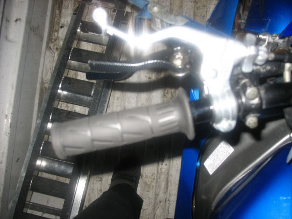

man i cant get mine setup to be comfy for 2 fingering. i want to try off peg coasters but i just dont have confidence in my setup. i got a moose perch and lever put on there today and it made stacking it alot better.... but its still all fucked because i have ALOT of play in my HB. mushy mushy.
ill go get a pic sometime tonight.
EDIT: o yeah HB on bottom

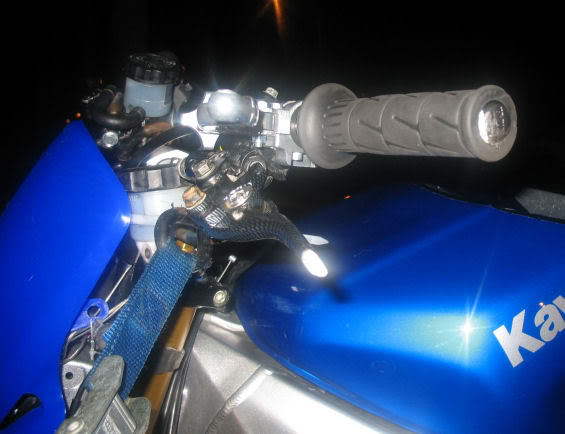

my HB setup and why cant i get it comfy for 2 fingering. i got no one here. im the only stunna!
top
side

move your clutch on the other side of the hb
and get a longer hb lever

Cut your clutch lever right after the bend in the middle of it. and rotate the clutch downward until it hits the perch for your handbrake.
Also, use a stock F4i cable adjuster in your moose perch. it will allow you o get th two closer together.

i thought everyone runs them with the HB closer the the stem? for leverage on the hb?
my HB lever is broken too. i need to get a new one
hrm ill try it tommorrow.

Most do run it in front. i do. thats not what im saying though. im saying decrease the distance betwen the two levers vertically...not side to side.

k stack em closer and cut after bend. will do tomorrow. and if im not lazy maybe the rear sprocket will go on along wiht the cage. especially if im gonna try my first off peg coasters.
