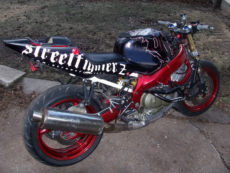

i just cut the top off of mine then cut the pipe again where the h for honda is. then welded it back together!! it sounds good and doesnt hit!
i love my quit stock pipe!
so thats all ya did? cut the cap off and cut where ya said then weld the cap back on? Didnt have to line up the inner exhaust pipe or weld inners first or anything like that???
