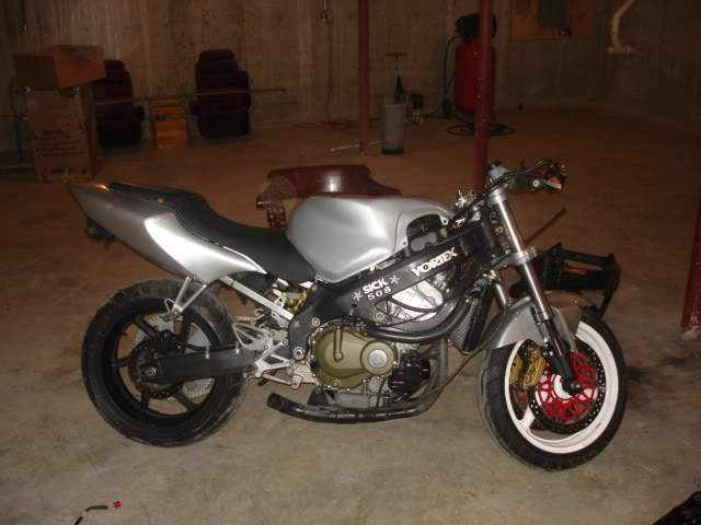

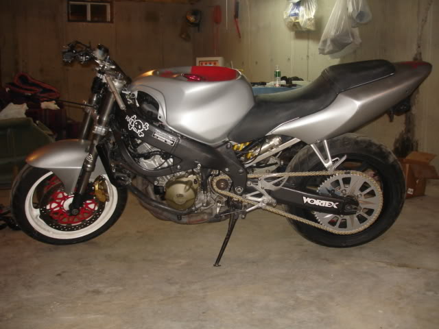

You dont need spacer , the spacer is same as f4 diameter....I used to rock one and now again i m rocking one ...heres a picture of my bike.

That garage is huge, I'm jealous!
Actually it is basement
Old Jan 24, 2007 | 01:38 PM
N/A's Avatar
N/A
Posts: 7,259
From: N/A
Re: 900 wheel on f4i
I was gonna say! All that basement needs now is about 2 beer pong tables!
