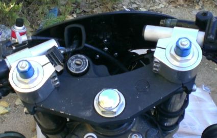

front is lower now
ever since I put these clip-ons on the front is lower cause I had to lower the tripple...you guys think it would be bad to push them up a little so only the two bottom bolt are around the fork tube? so the top would hang off a bit would this make stoppies easier or harder? what sthe best suspension setup for stoppies?

Ya you dont need to run the fork tubes all the way to the top of the clip on. I would keep them at least 1/2 way or more up though you dont want the clip on to come off doing a spreader.

ive seen people do that but ive always had my clipons under the triple (im a endo junkie) so I wouldn't know..

mine are on top stock, under the tripple would be really f*cked up

id say make it where the lower 2 pinch bolts have a good grip on the fork tube at least, go mid/hard on ur susp. settings for stoppies,good front tire, good condition brakes and practice

i wouldnt even come close to fukin with that.....cant imagine how bad that would be if it came off..... .02
