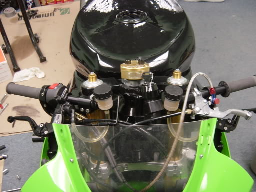

I changed my 03 636 master to a GSXR radial, I like it but Ive had Brembo radial masters on all my previous street bikes before I started stunting. So Im used to the radial feel and regular masters feel different and weak... Plus Im using the 05 rotors and the 05 uses the same master as the GSXR one, so basically its the 05 636 setup...Also use the same master as my HB

I know this is off topic, but is that an msr on your bike? If so, do you like it?
Sorry to jack the thread.
That is the original MSR raptor I liked but it was very weak, I now have the newer MSR PRO Raptor and its much better....

First off, I want an easy pull and the msr looks awesome. It fits perfect for a handbrake.
Second, Yes:YEAH I want to see the pm and response.
