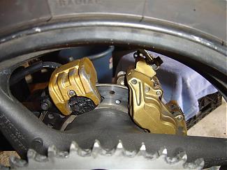

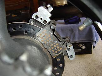

Okay here is a picture just incase anyone is interested this shows pretty well how the 4 piston caliper sits on the rear rotor I split a caliper in half for measurements reasons to double check prior to production. The pad seems to follow the rotor pretty good and is as close as possible without having the caliper rub the inner wheel. The caliper is perfectly centered also with this in mind I hoped to eliminate any need to worry about having to make it float. Guys I am not an engineer I tried with what I had to work with this is what I came up with. This idea of using a 4 piston caliper is not new just nobody has taken it to this level as far as having one actually machined that’s all I did. I could have save allot of money and just had someone weld a homemade bracket that would hold a 4 piston caliper to a F4i caliper but to be perfectly honest with you I wouldn’t want to chance it cracking at a weld and messing my self up. If I was to homemade a 4 piston caliper bracket I would have to "make a solid aluminum bracket" that would hold the 4 piston caliper then have it welded to a stock cast aluminum f4i bracket that’s too much work plus have you checked on what many welders downtown are charging to weld little stuff well in my opinion too much. I hope to hear back from the other dual caliper recipients. Thanks all
let me get this straight...
this bracket is for a f4i and i need a 636-03 rear caliper and a f4i front caliper to meka it complete???
looks great i need 4 of these pronto....

****, I didn't realize just how tight the tolerances were on the backside of the rotor till Ho Hey posted those pics.... there's only like a **** hair between the caliper and wheel.

Yup I wanted to make sure the front caliper brake pads lined up as best as possible on the rear rotor so its very close no other way of doing it nothing here was guessed its measured out best as possible.

ok is anybody else having problems with this other than me ???? im burning through brake pads literaly on a dialy basis doin all the same crap i used to do with the old setup . the pads arent hitting the rotor evenly and twards thge end of the day the h/b doesnt work anymore because the pads are hitting one another . anybody else having these issues ? please let me know . and the other two guys dont have there brackets on yet . i was out today with both of them

your probably just going through pads so fast cause your not breaking them in right. and i have only rode on it for 3 days since it winter here and i love mine. havent had any problems with it. im curious now to see what will happen when the hb pads get low. wonder if the part that isnt being used is going to hit and not touch my rotor
post pics of your setup man
