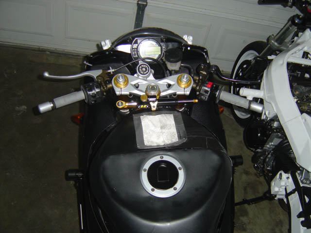

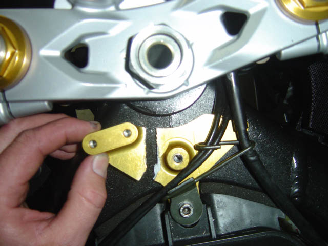

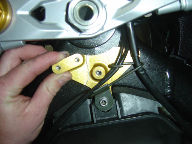

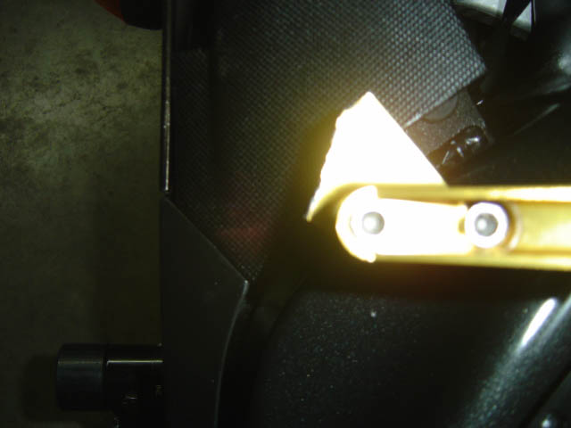

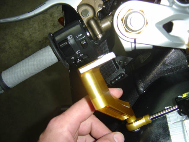

Just got my Hyperpro Damper for my 2005 636. I had it on 2 weeks and the lower bracket on the frame snapped. All I did was move the bike around in the garage turned the front wheel and it snapped. Hyperpro is replacing the part but not sure if this is a fix. If any of you guys are running the hyperpro on your 636 please look at it. The bracket flexs up and down when the setting is in the middle or high. Luckly mine broke just moving the bars rather than be in a endo and it tank slap and brake the bracket and crash. Look at the pics.

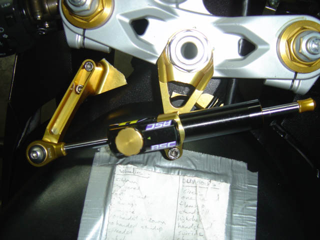

I welded my bracket back together so it is back on the bike until I get my new one. Here are some more pics Nick you cant read the list.

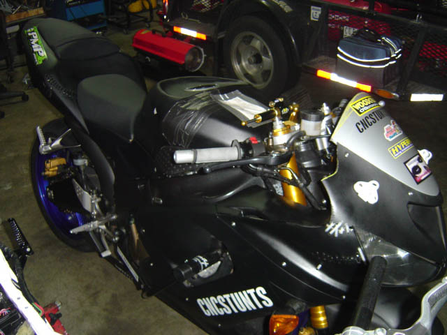

Re: 2005 2006 Kawasaki 636 Hyperpro Damper PICS

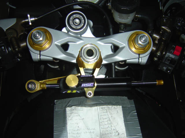

I think with the duct tape Kane wouldnt approve of my bike it is so trash!!
i tapped a hole on each side of the mount and bolted it down to the frame. it stops it from wobbleing and gives better feal on the frontend. if its wobbleing the brackek starts to crack when put under stress than it just gives.
