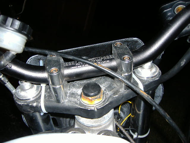

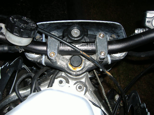

like this
ID:	184832   Click image for larger version
Old Dec 4, 2006 | 03:42 PM
banjaxed's Avatar
im nico, i do wheelies
Posts: 2,146
From: O-TOWN, FL
Re: freestyle ingenuity handlebar risers....
^ tag clamps bolted to stock triple

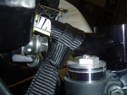

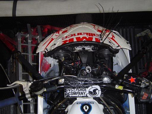

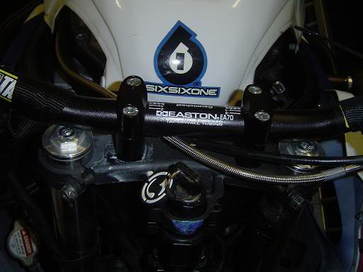

ya you can get tags in 1-1/8 and 7/8 so its what ever you want for bars i run protaper 1-1/8 carmichal(dont know the spelling lol). to put them on you need to drop your tubes in the forks a little not much.
heres some pics
heres where the tube will sit (its not hittin the bar its real close though)
front view
heres the sky shot with pad
heres some pics
front view
did you HAVE to buy aftermarket brake lines???

Old Dec 4, 2006 | 04:26 PM
AsphaltAssault's Avatar
Posts: 560
From: northeast
AsphaltAssault is an unknown quantity at this point
factory fx makes it. any parts unlimited dealer can get you one look in the 06 dirt catalog. im a parts unlimited dealer thats how i know what book its in. some of my buddies got new lines but i was able to get away with my stock one. i didnt zipty it to the forks though so it really just hanging there but it works.
