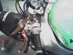

Got it all hooked up last night.It only took me 20 minutes to hook it up & bleed it by myself! Works awesome, has so much feel its stupid!
Gotta junk these stock clipons so I can place the levers where I want them.(Can't believe these stockers lasted so long)
