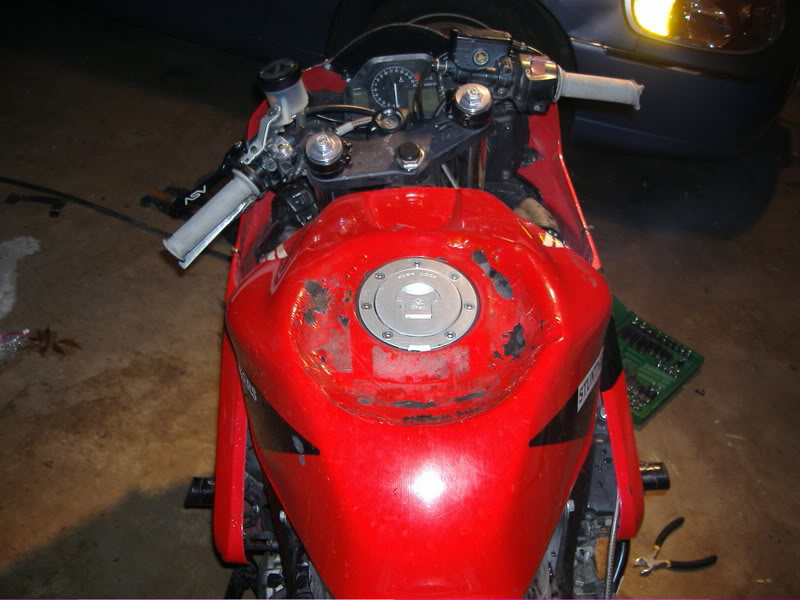

Here's one...We ended up denting it again and got it alot deeper. I will look for the pics after we got it dented in deeper

so did you just bash behind the gas cap on the tank

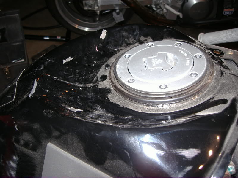

here's the tank without the cover..

aww i seee you use some kind of body hamer or just a regular hammer? now what about the plastic cover did you just heat it up with a torch?

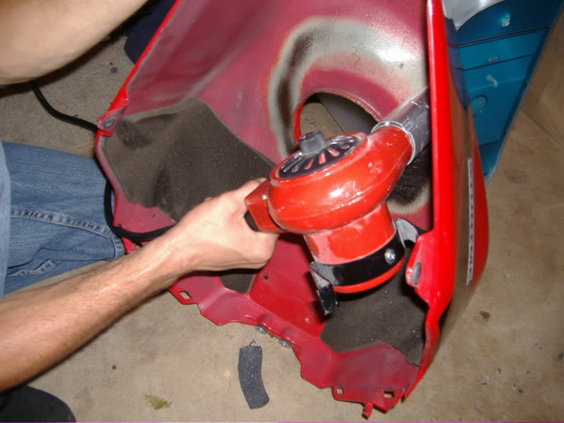

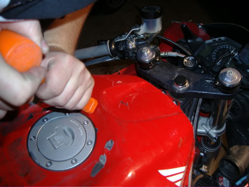

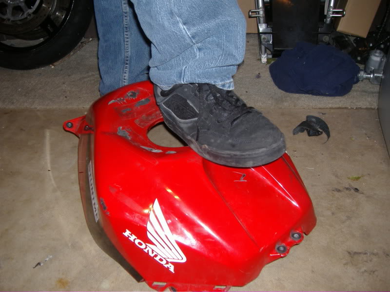

Use a dead blow hammer on your tank. I works way better than a rubber mallet or a metal body hammer. You can get one at any auto parts store. Then after you beat the tank down heat the cover with a heat gun and start working it down into place. It took us a while to get the cover to fit right. I would heat the plastic then push it down to the metal with the end of the hammer then pour water on it to cool it down fast and keep the shape. It takes a long time compared to a regular tank but its not hard.

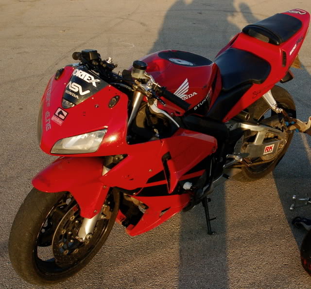

this is the only other pic I have...pm spiller03 if you have more questions its his bike I just helped him dent the tank
