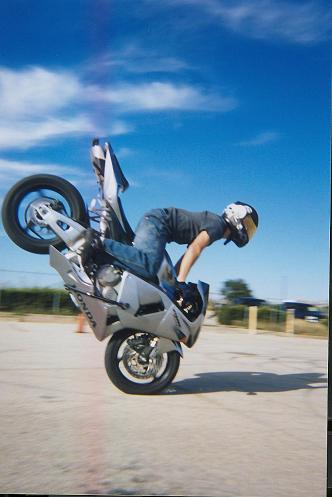

youve got to push on your clip ons or thats wat i do if the back end starts to go the right push on the right clip on, but unless your balanced or floating it is pretty hard to ster jus practice them from like 40mph dont try higher speed for longer distance u want low speed long distance i hit 214ft off 100ft approach
Damn, you are wayyyyy over the front of your bike. I don't think I've ever seen someone so far over the front of their bike.
+1 i cant tell if hes about to kiss pavement or roll a sick stoppie...
obviously you have never seen FSPalex

I like being way over the front of the bike, the steeper you are the easier they are to manuvuer. just do them over and over again and u find yourself steering them and that is how you keep them from kicking out on you.
